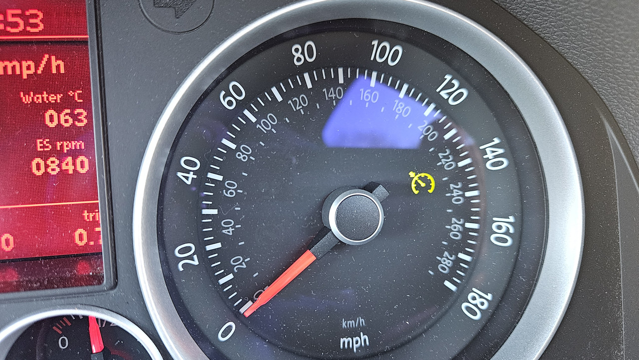

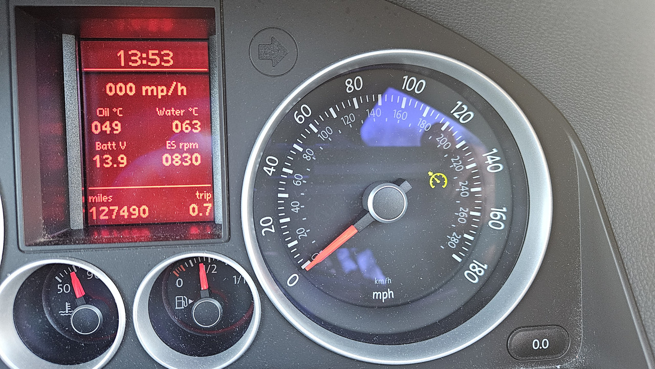

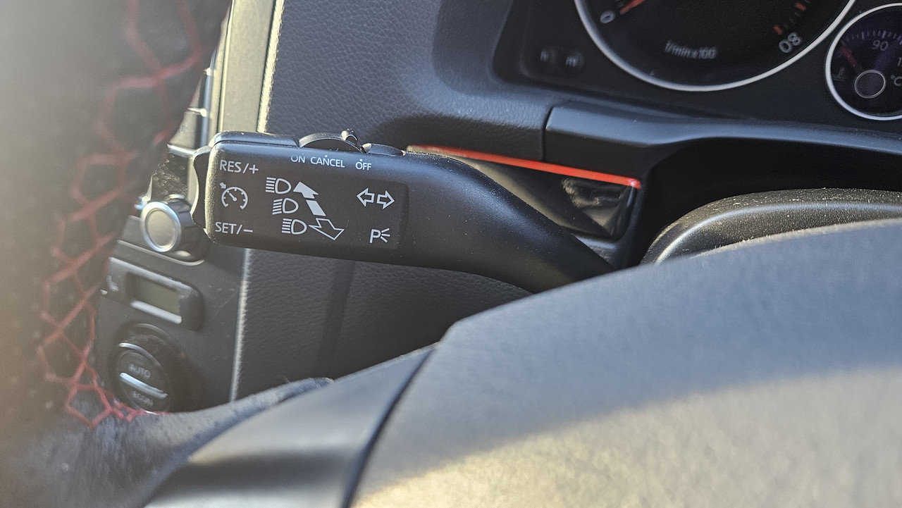

Been planning to retrofit cruise control to the GTI and finally did it today.
Hardest part was fitting the missing control wire with mine being a 2005 and missing it. I made and then added the missing control wire as people ask stupid money for it,  by ordering the different male and female pins to fit the connectors etc.....fitted and worked perfectly. I also got a secondhand stalk 1K0953513G off eBay for £13 and went ahead to fit. I already have the highline dash and modules so was sorted there. Coded it up and all works great  :happy2: For the total cost of £30 in parts.

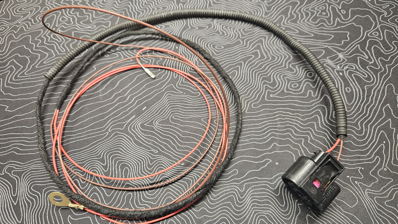

Acquired parts and loom made for fitting a washer fluid level sensor. I still have to tape and sleeve it, but good to go
Need to find some time to fit and code in
I have also bought the larger 5.5 litre reservoir to replace the current 3 litre one
UPDATE: Loom is now wrapped and shielded

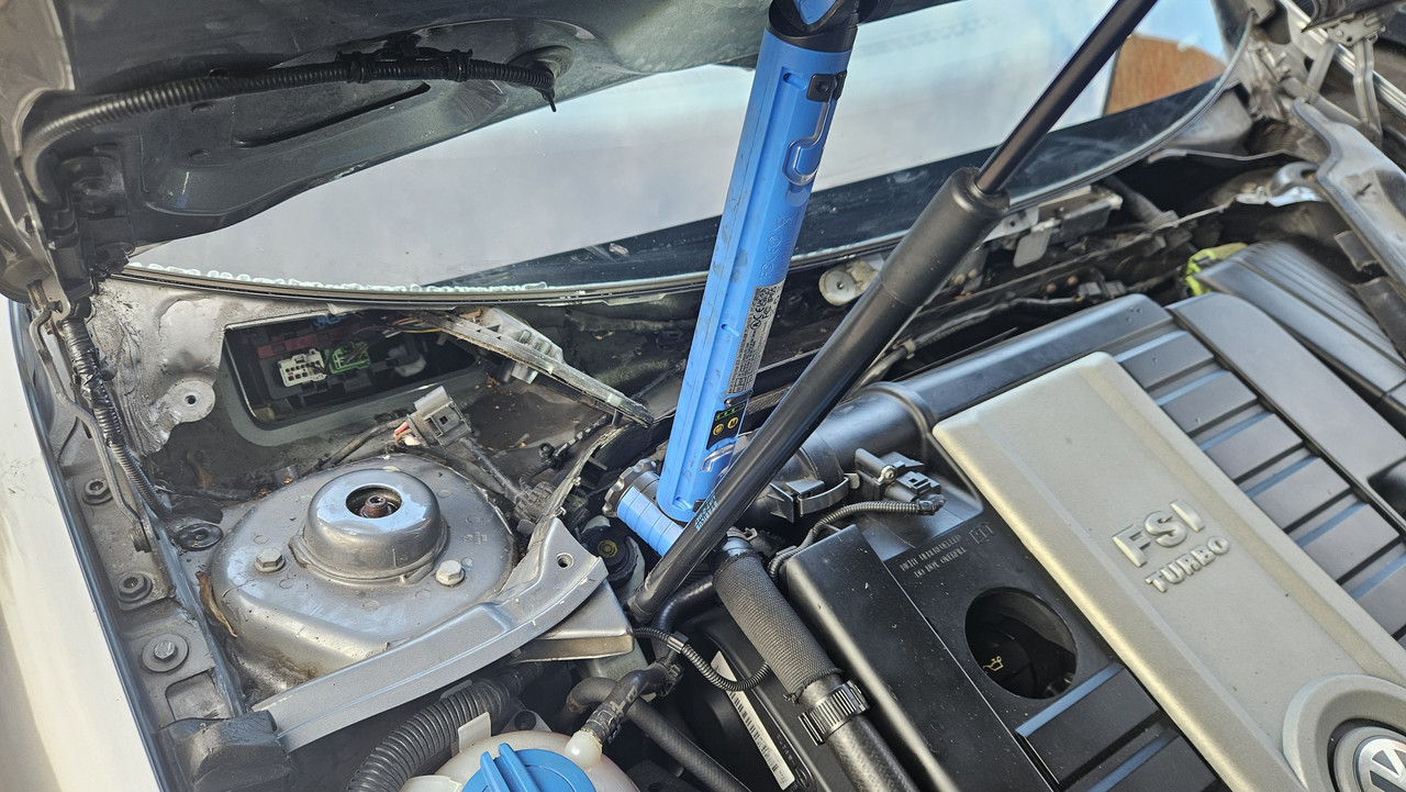

« Reply #12883 on: January 24, 2026, 07:53:14 pm »
Took delivery of the 5.5 litre reservoir that is used with the headlight washer system. Weirdly this one came off a Seat Leon mk2 2010 without a headlight washer system or a level sensor, but all holes were there with factory bungs in which suits me fine. Pulled the level sensor bung out and fitted mine.
