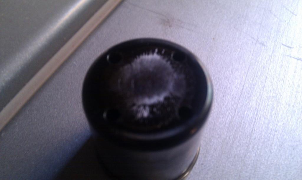

I had done just under 90K, and old one looked like this:
Shame your not more local Alex as could have helped out.

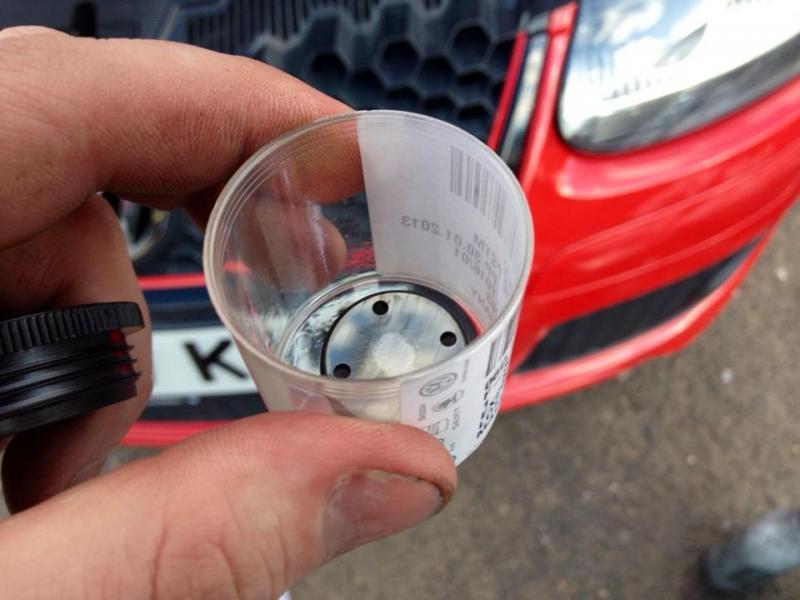

Changed mine out at the weekend, no banjo bolt so a straightforward task.
2007 car with 49,000 miles. The DLC has worn off from the centre outwards, so was just right for a change. Cam lobe was nice and unmarked.

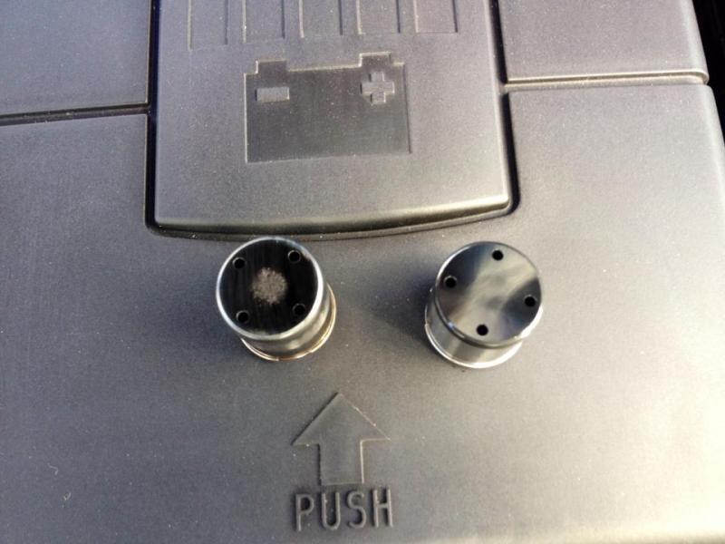

Had an early finish at 4PM today so ordered a new follower at 12:30PM today from TPS and cracked on with it when I got home, Took me 45mins with no issue's at all.
As already echoed on the forum for the time this takes to replace and how straight forward the job it to do I would encourage anyone with a TFSI powered car to replace theirs!
Taken from my ED30 which turned 54K miles today and is a standard car with full VWSH, Very happy with my findings to see little wear on the follower and the camshaft in excellent condition also....

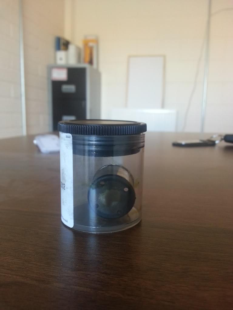

From my 56 DSG gti 98,888 miles
