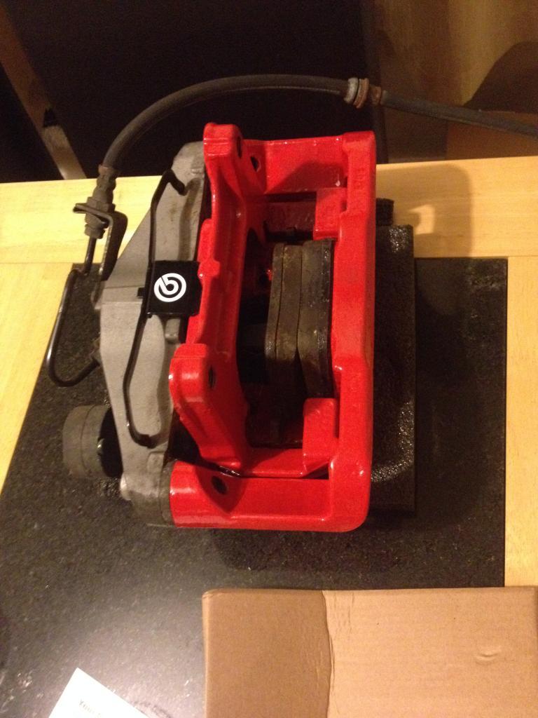

I just want to confirm before i go ahead and fit my new brakes. My 6 GTI which has 312mm, I have just bought a set of R32 front brake set up, is it just a straight disk and caliper swap, no different bracket needed?

Offline GTI-Ross
  • Posts: 1057
  • Learning All The Time :)
Re: POLL: War of the brakes
« Reply #49 on: July 04, 2014, 09:03:42 pm »
can someone clear it up please, need to know if its the same bracket. Thanks
R32 brake disc is 345mm and thicker than GTi brake disc which is 312mm.
Carrier is larger to hold the much larger R32 brake caliper.  Part numbers are also different which suggests they are different.
You also need to change the brake lines, pads etc.
Here's an image I found as a comparison for the carriers...
Offline GTI-Ross
  • Posts: 1057
« Reply #53 on: July 04, 2014, 10:59:47 pm »
Ok thanks for clearing that up, I kinda thought that was classed as part of the caliper ( I a noob when it comes to brakes), Well i think I should be fine as this is the set ive got and it looks like the carries are pre-attached to the calipers.
With those you are cleared for takeoff ;)
You only miss the MOT dustshields  :wink:

Not doing it my self now and i could do with a full brake fluid change. I thought with these you just bend the GTI dust shields backwards a bit. People said no pint buying R32 unless your really fussy, this true?

Dust shields and new brake lines, do it properly... Not expensive. Can you take a close up of the anti rattle clip? I like the icon!!
