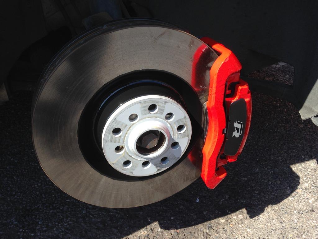

hi all..just another update..well over the last 3 weeks or so I have been collecting all the parts needed for my R32 brake conversion and to be fair their has been a lot to collect. when I decided to upgrade the brakes I thought buying some used ones  and then getting them refurbished would be a good money saving idea. How Wong I was. Anyway ended up buying a new caliper as the used one was not great so all in it has cost be £600 had a good deal on some brembo discs and pads.. got to say it has been one of the best mods so far...these and the standard GTI brakes are miles apart.. also had to run 10mm spacers up front  to clear the brakes ive got some h&R ones on order at the mo...

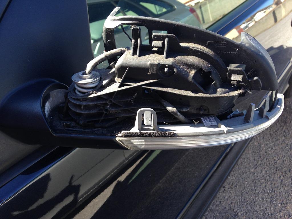

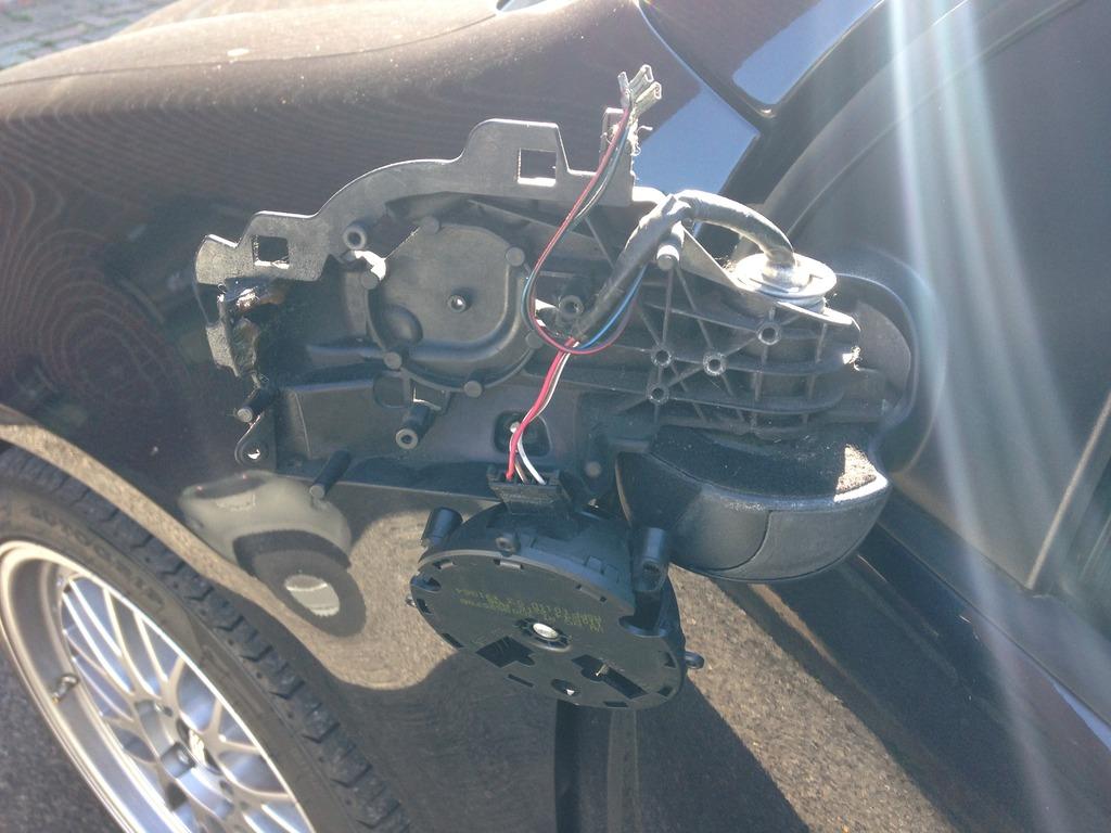

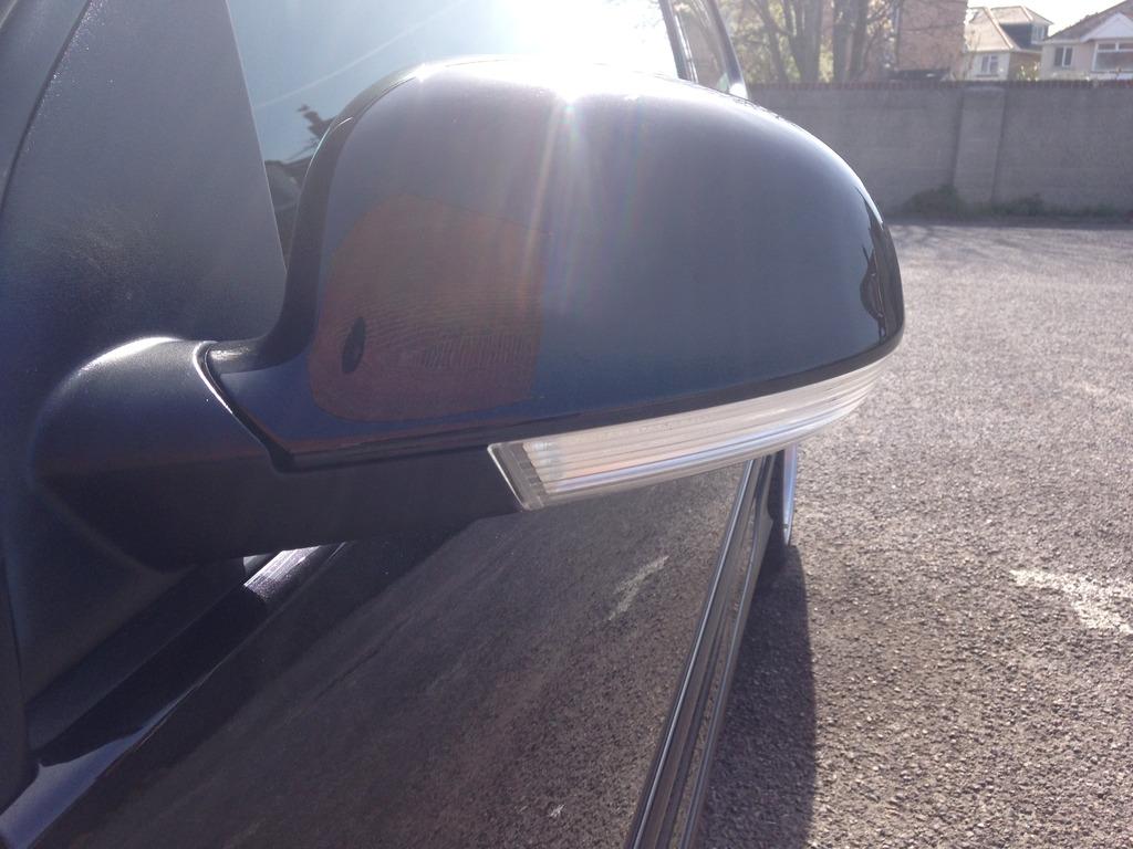

Hi not updated anything for a while but now the weathers getting better i got to do a couple of small jobs done ..first of all decided to replace my wing mirror indicator lens mine were looking yellow so got myself a pair of genuine vw items ..miles better I now have replaced all the lights on the car. it's the small things that count we all now that..........
Before
During
After

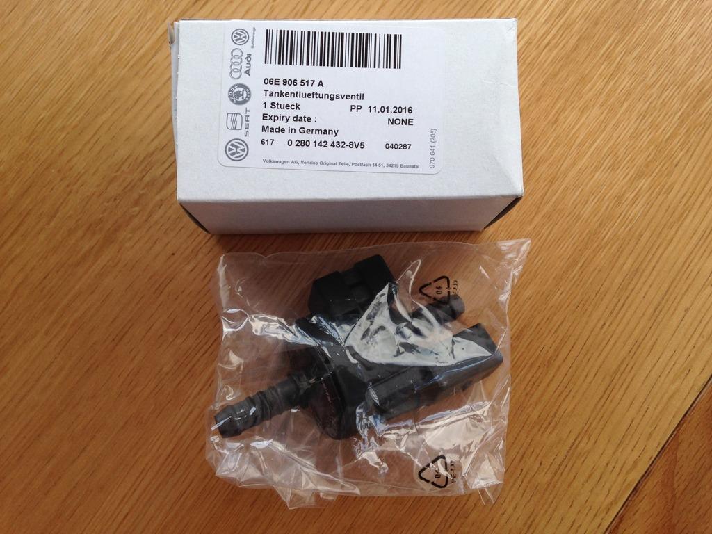

Anyway  all was fine until the afternoon when the engine warning light came on..The car did not feel any different so I cracked on. once I was home I plugged in my £25 engine code reader I got from ebay.. Which came up with the code P0441 EMISSION CONTROL INCORRECT FLOW. So decided to do a bit a research then went back to the car checked the carbon canister and pipe work for breaks or splits nothing.. but this valve was making a lot of noise so decided to replace it..I then turned off the engine light job done.
New Valve
And Fitted

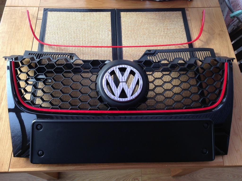

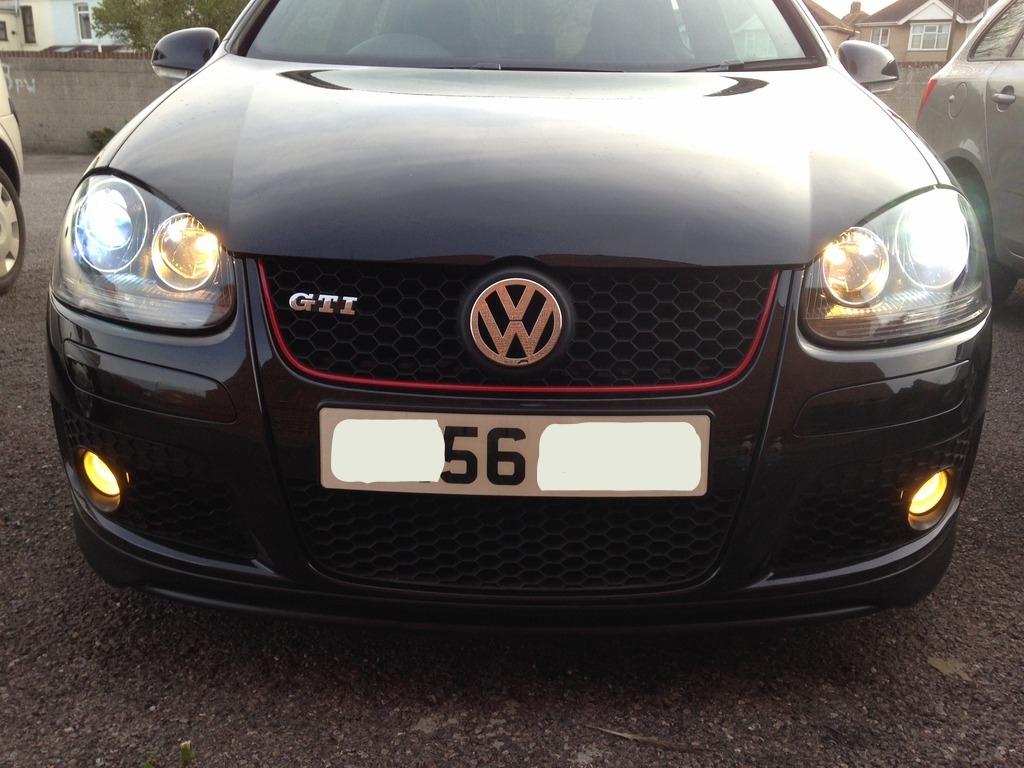

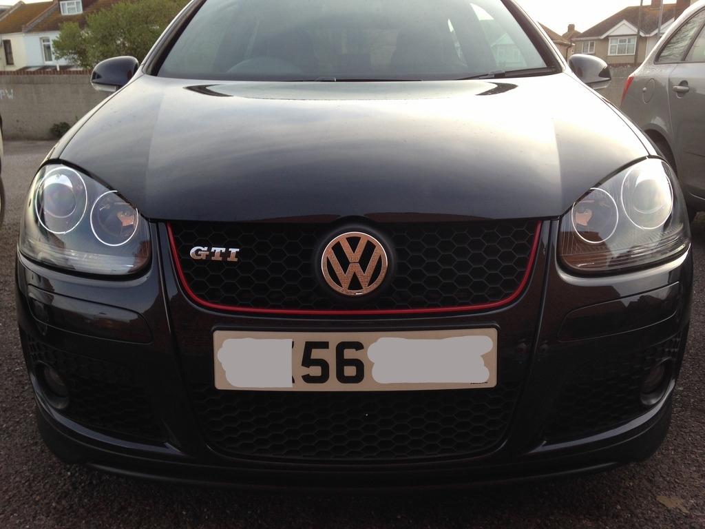

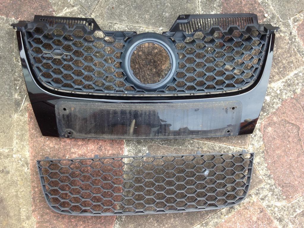

Next job was to replace the grill fed up of it being faded.... so I brought is an after market one off ebay. The build quality is great apart from the gti badge and the red pin stripe. Its very good and a perfect fit I used the pin stripe and gti badge of my original grill..going to use the old grill for a project respray graphite Gray and gloss back...and a different pin stripe colour
Old Grill
NEW GRILL
And Fitted

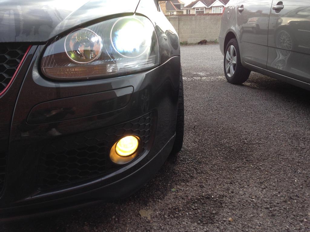

NEW YELLOW FOG LIGHT BULBS
And fitted

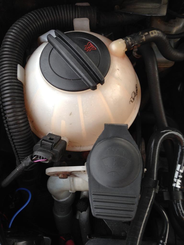

[size=14pt]Black coolant and washer bottle caps
I think these will look great on the brakes once I have repainted them not the cheapest things in the world....also been thinking and have decided to do the R32 rear exhaust and valance I know I should have done it first time round so will be selling my milltek soon I guess,,,,

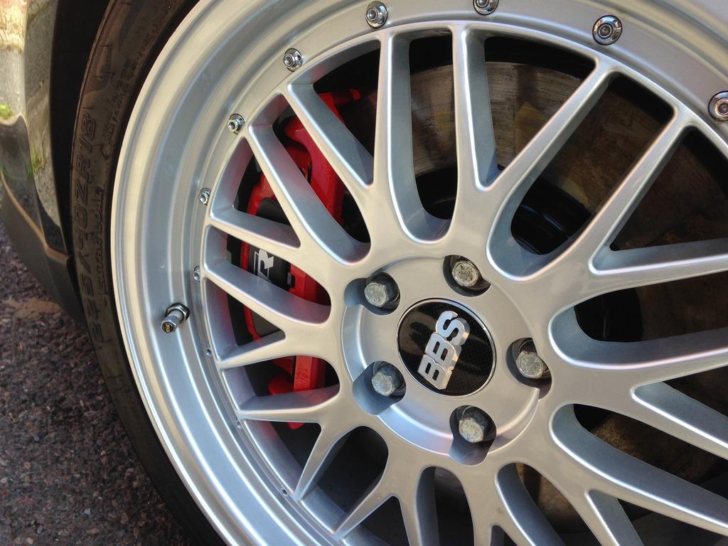

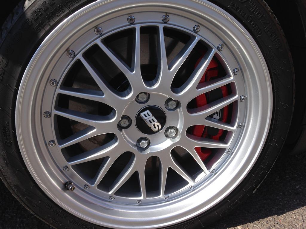

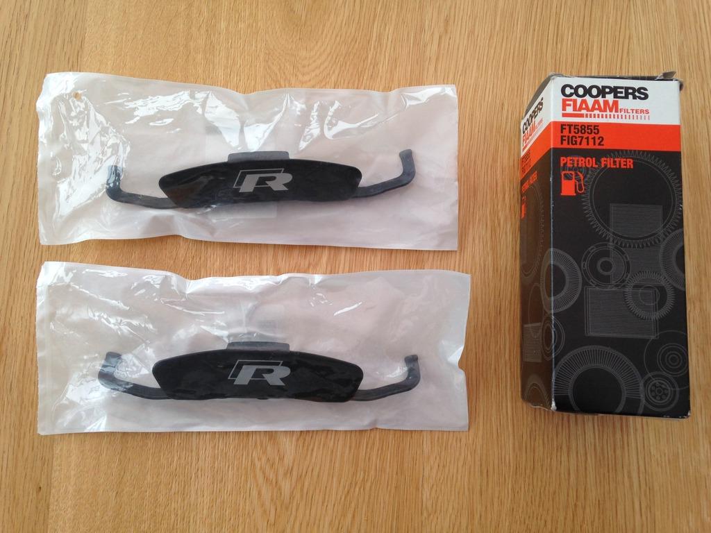

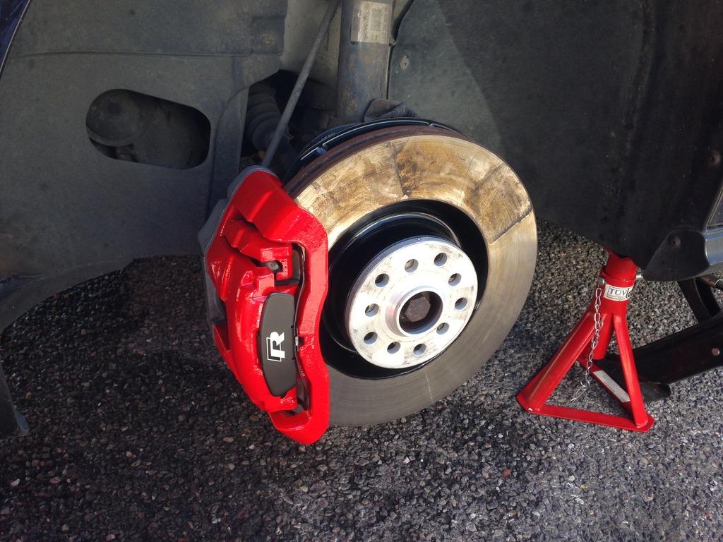

cheers for the comments guys...I appreciate it..Just a small update ive got the week off work . Weathers great so decided to get amongst it and crack on with the brakes giving them a quick coat and then get the new spring clips fitted also gave the disc inners a coat of hammerite smooth they came out well and with the new clips it looks 10o% better
